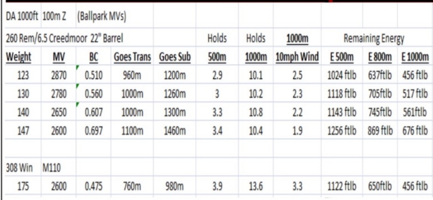

Ballistics results are like statistics you can choose the worst bullet ever made or the best one or the one you would buy at the shop.
The Berger 175 OTM still supersonic at 1000 yrds .
Then for a closer comparison a Berger 168grn classic hunter at 2850
The 6.5mm 147 using your BC of 0.697 at 2600fps
Taking like for like, the 175 eld-x at 2600fps (from a 7mm08, for instance) doesn’t go transonic until 1150-1200m. That is another 200m before hitting transonic than a 175gn bullet out of the 308 and that’s just from necking the same cartridge down by 0.63".

A 180eld out of a 308 at 2800fps (which I think is really pushing the boundaries for a 308 pressure wise) goes transonic at between 1000-1100m.
When they start making rules for competitions because the ā€˜standard’ cartridge is no longer competitive and they need to stop people ā€œcheatingā€ with more modern and efficient cartridges, I think it speaks for itself. Yes, the 308 is still a good round but the reality is there are a heap of better, more efficient cartridges with similar capacities available to the modern shooter wanting to reach out to 1000m and more.
The FTR guys push the 200 out at 2850+ for the 185s it is close to 3000. They give you a pretty hard recoil and are hard on the cases but the normal signs most people would look for pressure is not there.
I’ll take less wind drift any day. Over 2 ft less @ 1000 yards? sign me up.
