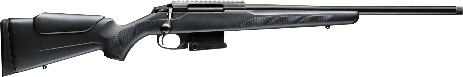

Tikka T3 CTR
The baseline, my first rifle :smiley: Albeit when I got it, it looked this (notice threaded barrel):
First change was the brake.
This reduced recoil a lot. I can’t really quantify it, more than 223. A lot less than 308.
T3 CTR comes with a threaded barrel, so I fitted it myself, although the first go I got the lock nut the wrong way. Anyway, entire thing took about 30 minutes to do, because I wanted it perfectly levelled (or shall we say timed?). When fitting, I also tapped parts, to avoid scratching, etc.
