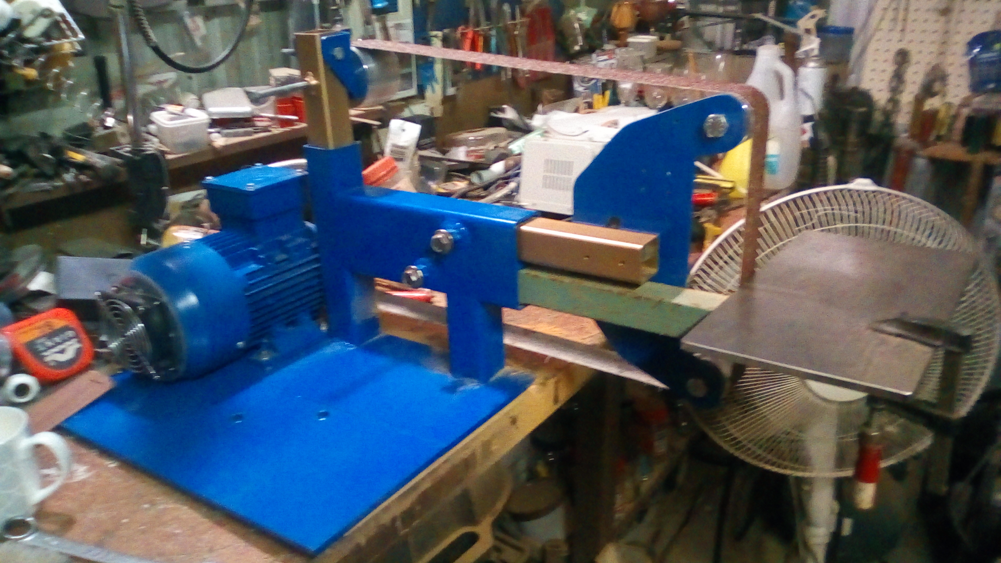

I’ll start it off with my latest build, a 2x72 inch belt grinder for knife making etc…

@darwindingo…the wooden handle is from a Lee 6 cavity mold. I made the rest though. Thanks!

Random pic of the belt grinder in action…
Fark me and to think I used to use file’s. Sheesh, can be done but

Your belt grinder looks great, by the way! I need one before i do any more knife work. My ‘multi tool’ was a good starting point but i’m keen to step up my game and a 72" grinder is the way to go!

The 72 was a pretty easy build, although if I was to build it again I would add a third tool arm receiver on the frame, give more options and would have saved me from having to fart around making and aligning a tool rest arm that allowed full access to the platen. So if you make one keep that in mind. Used a 2hp 3 phase (considered 3hp but the 2hp is perfect) with a vfd so it would have speed control, didn’t want to have the small wheel attachment explode in my face because it was doing some crazy rpm.
While the multi tool grinder may have some limitations you have turned out some amazing knifes with it mate !. With the vast array of quality belts , grits and attatchments you can run, make the 72 a worthy investment.
