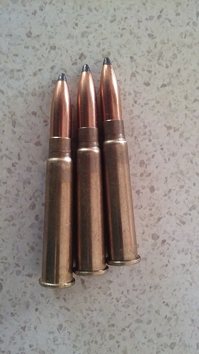

normal 303 brass on the left, notice the ring on the case mouth of thr one on the right and the longer neck.

I manage this by using the rifle chamber to resize the brass after trimming 2mm off of it, then forcing the bolt handle closed, which without a projectile was pretty easy, just awkward.
Before and after of the brass
Some loaded rounds ready for safe shooting.
