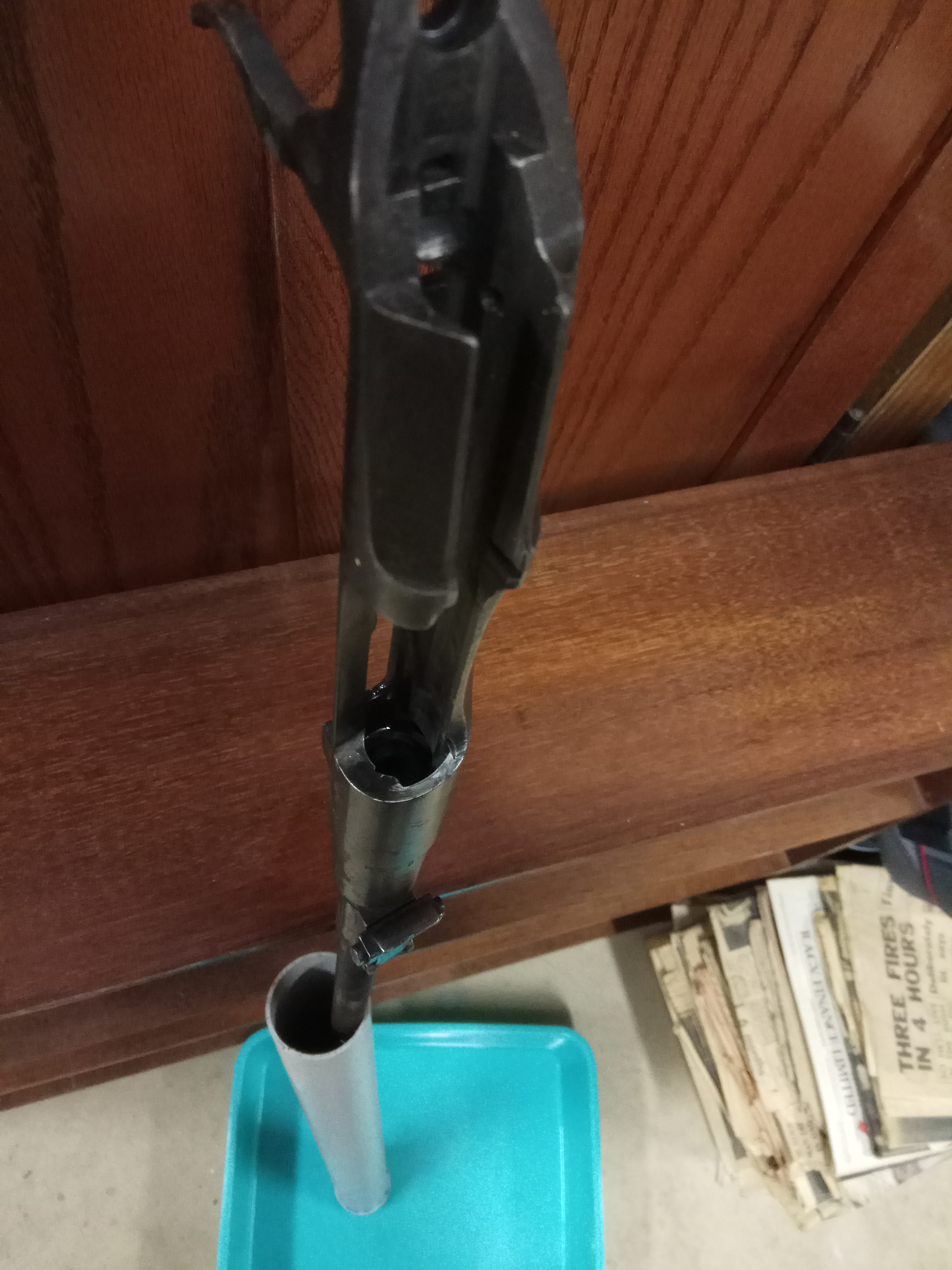

The initial plan was to soak the whole barrel and action in a capped PVC pipe which Dad had laying around from some previous project. Unfortunately, it wouldn’t fit due to the massive bayonet hinge on the side. Instead, I plugged the barrel with two foam earplugs, stood it all up in the PVC pipe and syringed turps into it and lett it overnight. The next morning, I removed the plugs and little chunks of black stuff came out along with the now brown turps. Oh good…

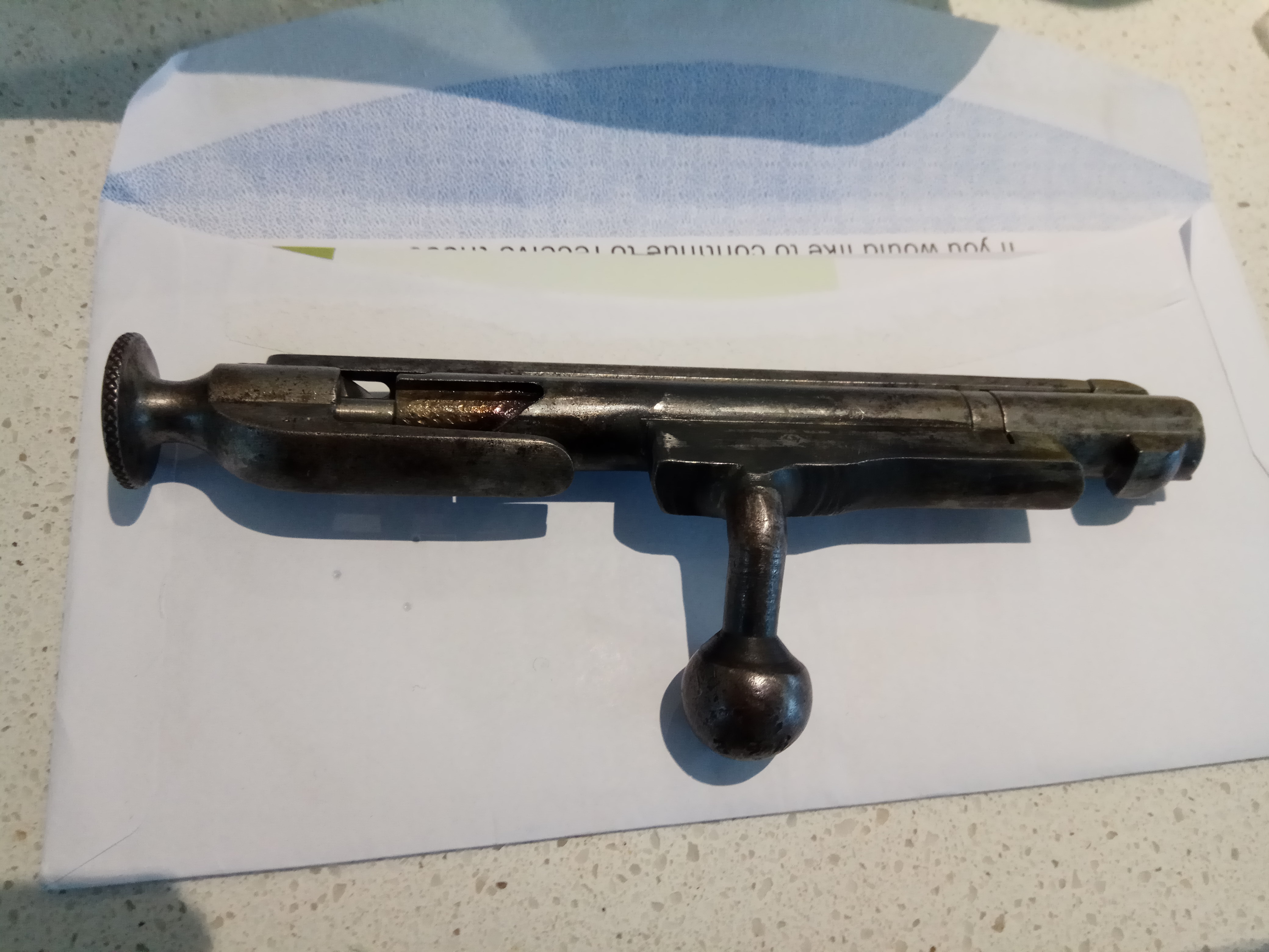

In between all the brushing and flushing, I also got the bolt back together. Given the large number of stamps on it, I suspect that this isn’t a Chinese bolt. Internet law seems to be that the Chinese bolts were usually only marked with a 21 in a diamond and nothing else. It has also been turned down at some point which is odd and a pain. I may end up with a new bolt in the future.
