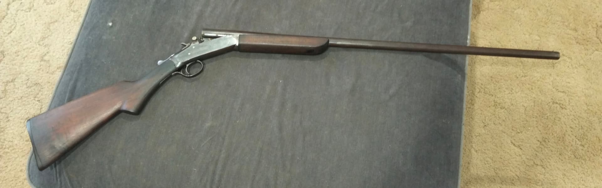

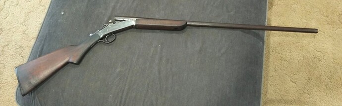

So unsurprisingly to anyone I got an old single barrel shotgun.

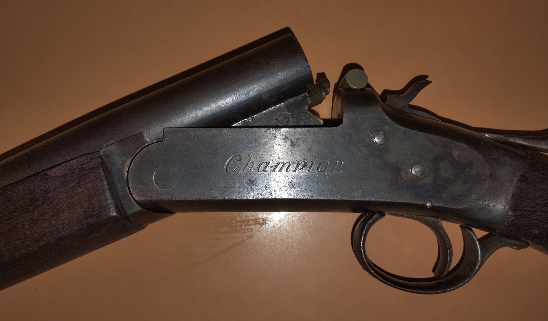

An Iver Johnson Champion, made by Cooey in Canada in 1932 or 33. Iver Johnson had Cooey make these to dodge tariffs on exporting them from the US to the land of ‘Sorry Aye!’ and then further on to other Commonwealth countries.

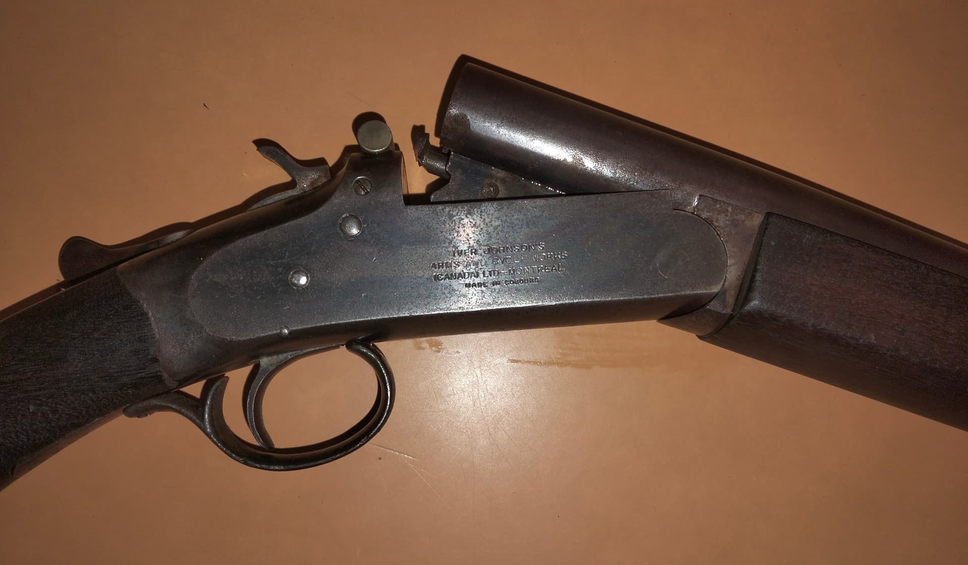

This one had an issue where the top lever that opens the action would spring all the way over to the left almost 90° past where it should rest along the top of the wrist, this also caused the internal parts to block the hammer so that it wouldn’t cock. I did some research, watched a couple of YouTube vids and pulled it completely to bits and then put it back together just to make sure I could.
Then I stripped it again to Tweek the transfer bar and hopefully fix it. Well fuck me, adjustment to the transfer bar was simple, but then I’ve spent the next 3 days resisting the urge to throw it through a window. It was so simple the first time, but it took me 600 trys to get the hammer aligned and the pin back in this time. There’s no interference from the transfer bar, I just must of fluked it the first time. You need to push the hammer back against the main spring to line it up and get the pin in, in the end I made a tapered pin, got that in there and then drifted that one out the other side with the correct pin.
But she’s done and functional again now. I’ll take it and test fire at the pistol club tomorrow.
