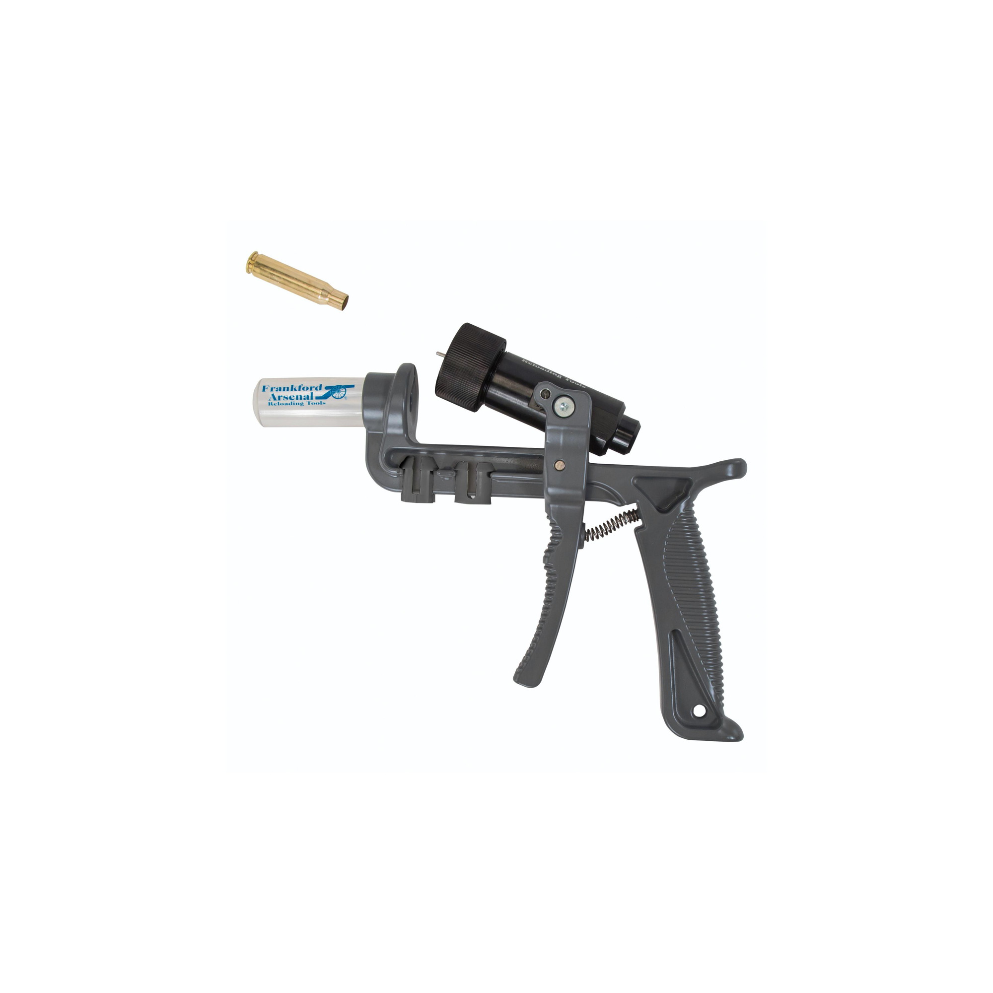

I run this, can sit in front of the telly or whatever. I did just do 500 223 on a progressive but.
But how do you connect a case feeder to it? :slight_smile:
Im gonna watch that in action on youtube. Now to put this second batch on with some soap flakes and warm water.
You don’t, i just leave the bushing loose so the case drops out. Not as good as a case fed progressive but.
