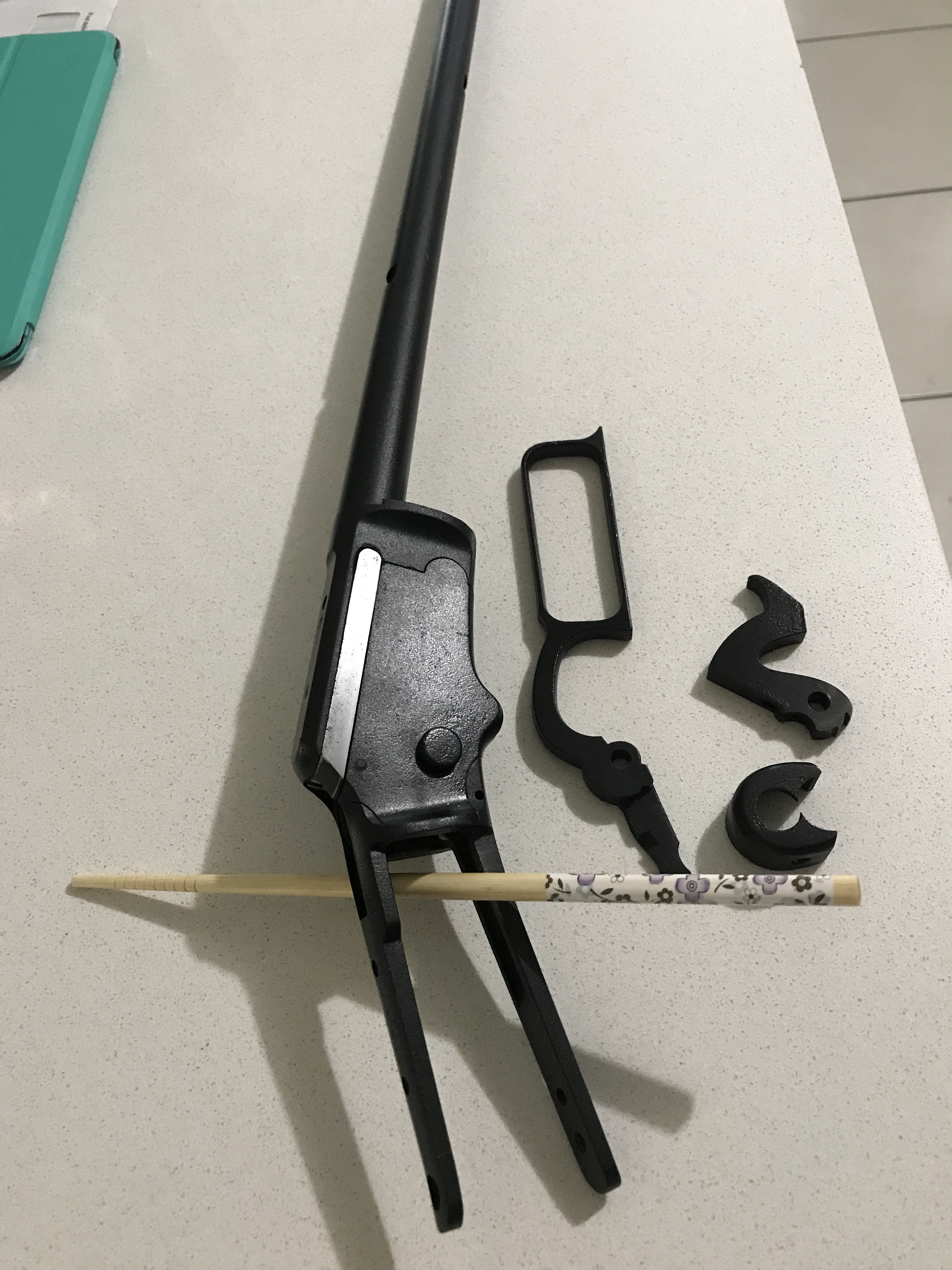

I’m normally one of great optimism but think this one is going to test my patience. This little rifle(well parts attach to a piece of wood) came to me in a pretty cool way, a neighbour of a friend was cleaning his backyard up and found this little rig in the dirt where hes parents once had a shed. So the neighbour Gave it to my friend, he works at the LGS which passed it onto myself at the cost of a PTA. Now I’m at point of testing function which was done last night and I’m tearing it down as we speak. One thing that stands out is I’m going to need to fabricate a new firing pin which is missing, and the hammer doesn’t stay cocked as it lets go when bumped (not very safe). Hopefully I can get started on the rust removal by electrolysis this afternoon and really Clean this rifle up. Does anyone On the lobby have a similar rifle if so I possibly get some technical dimensions from the from the firing pin? If not I will just hand fit one, as for the hammer spontaneously letting go I’ll will build up the wear with the Tig on the cocking piece and see if it elevates the issue. image|375x500
Pic of the firing pin

Quick up date after a bit of research this firearmss date of manufacture is 1904 according to oldguns.net.
Have the lever currently undergoing electrolysis as it was the worst part. The receiver and barrel are up next when I get a big enough tub lol

Quick update on the girl she’s coming along nicely. In the process of fabricating a new firing pin thanks to good people at wisners inc in the states for sending me the specs so I’ll share them here. After cleaning the bore it seem as thought someone has ran a rifling button through their anyone seen this sort of thing before? In other words two sets of rifling. The action has Been sand blasted parkerised then powder coated in a charcoal semi matte finish. Been working on a stock also can you guess the Aussie hardwood? As it’s just a 22lr I think this timber may prove heftier than its walnut counterpart but once I stabilise it it should work just fine for this rifle. Enough ramblings let’s get on with the pics
