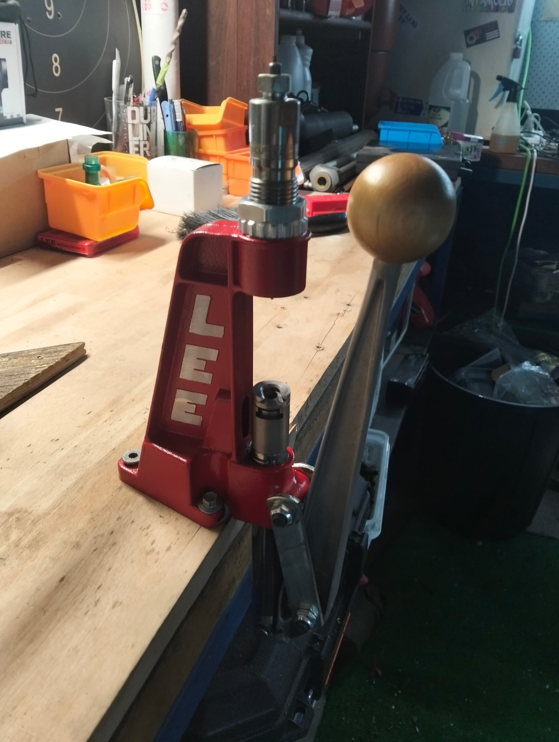

Lee Breech Lock press
My Redding Big Boss shit the bed this week. This was the cheapest press I could find to keep me going while I squirrel away a few bucks to get something decent again.
Pros:
Only $146
it’s technically a reloading press
Great access
Will fit in a shoebox sized reloading room
Cons:
You get what you pay for
Ram is a bit sloppy

It’ll get me through this pile of 9mm, but be fucked if I’d wanna arm wrestle 30-06 on the thing.

So I’ve deprimed and resized a few hundred 9mm cases on it now and I don’t hate it. I think for someone just getting into reloading and only doing smaller rounds, pistol cases and probably up to any of the 308 case family (.308, .243, 7mm-08, .22-250 etc.).
Since it’s a flimsy single sided press the handle geometry has been designed so that it won’t put the sort of torque into it to reform brass or probably resize big magnum brass. Definitely wouldn’t have the precision serious target shooters would want, the frame would definitely flex when you lean on the handle a bit.
But it works and it’s definitely a cheap way to start reloading if you’re thinking about it, but not sure if you want to pour a ton of money into it.
