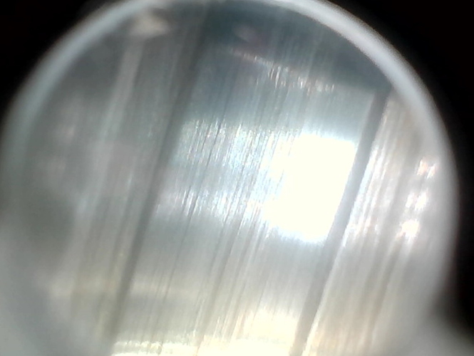

I found a little copper and a little bit of scratching right on the freeboar to rifling junction. somewhere I think you would expect to see some wear and tear.
I will post some pictures up in the near future. Right now I want to do some inspections.
Kinda really needs photos here… Otherwise words are hard :frowning: My bird brain needs pictorials.
@juststarting ok hope these work as I put the scope on an old laptop with none of the accessory programs I normally use.
They are very good quality pictures and are nice and clear even when you zoom right in. Shows the wear nicely and for $90 is a great investment.
Bugger now I need/want one …
I think I could do better, you can adjust the distance of the mirror which I have only just tried, these pictures were taken in a bit of a hurry to get them up here. like anything a bit more experience and some tweaking should sharpen the pics up a bit.
