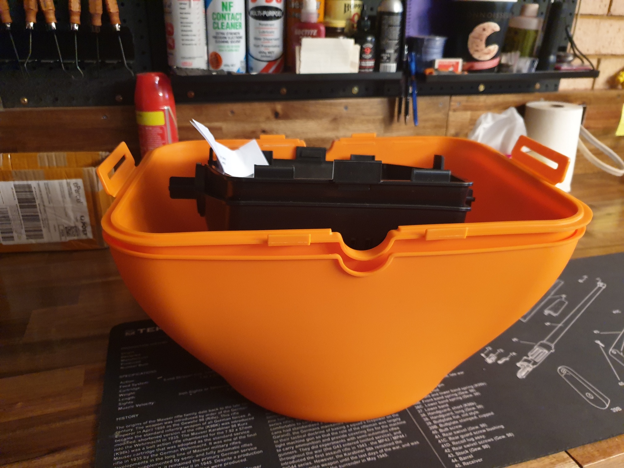

So like all of the others on here who wet tumble I was always looking at an easier way to get the stainless steel pins out of the cases without them going everywhere.in the end I bit the bullet (so to speak) and brought one of these:
Now they were designed for separating dry media but I don’t see why it doesn’t work with the pins as well. I will find out on the weekend when I put through a batch of cases that I will be cleaning. figured I can’t go wrong for $55.

Test day today, ran a couple of loads of fresh tumbled 9mm cases, and put them through the media separator. Well I thought that I might find the odd one or two pins still in the cases but found none at all.
I just drained the water out of the tumbler and tipped the cases and pins into the basket, put the lid on and cranked the handle about 10 times in each direction and then checked them out. perfect and ten times quicker than the old way.
Very happy indeed and would recommend anyone who tumbles a lot of brass to get have a look at one. Should work fine with rifle cases as well as it cleans dry media out of them.
